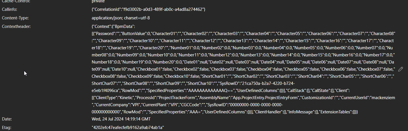

I examined the console tab and I can see it isn’t even querying the data
Now the question is how can I add those custom fields to this, right?
That’s just the header, you need to look at the request and response.
The response isn’t providing any of that data. Where would I look at the request?
Another thought I’m having is, is there a way to personalize a default column view for all users or do they have to each personalize them? For this situation specifically, when they use the working search, it lists a lot of the UD01 fields, Key1-5, Character01-20, Shortchar01-20, etc. Is there a way to standardize that view for all users?
Payload
This is all I have in the Payload, it doesn’t seem right
