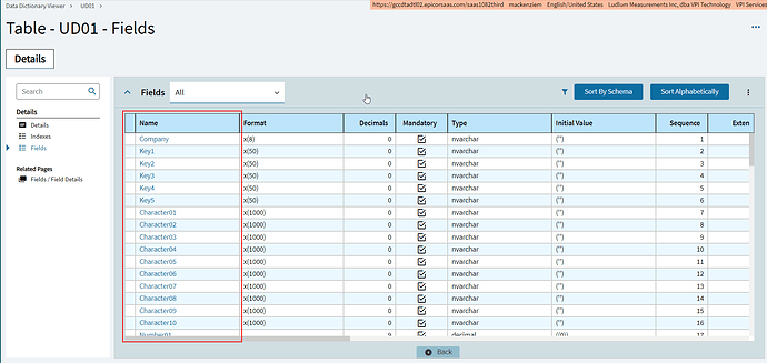

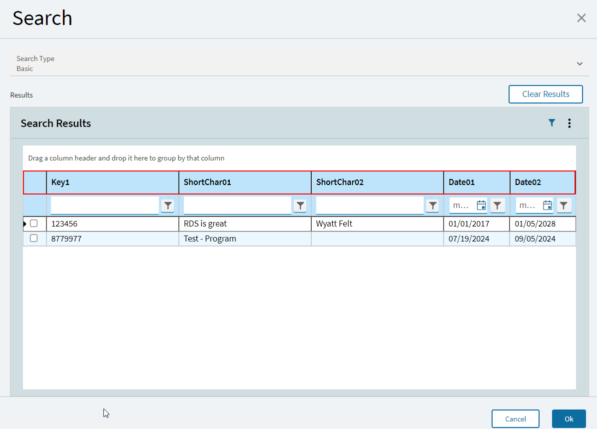

We are using the built in table UD01 to populate some custom data, and when I created a searchable text field to search that table, it returns all the column headers and the default names. Is there any way to rename these Column names?

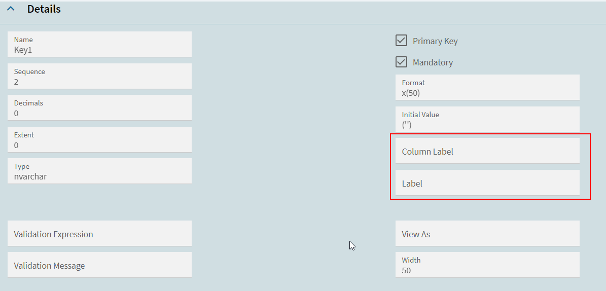

I’m assuming it would be Column Label or Label
But cannot find away to edit them.

Try Extended Properties?
I don’t believe there is a way to change the Key fields, but believe you can change the other fields labels in extended properties. If you really want to go crazy, you can use a UD table off of a UD table and create all the fields you want except for the Key fields.

Thanks everyone for the advice. I have changed ShortChar01 Label to Program Name in the Extended Properties, but when I search that table, it doesn’t return that value, still stuck on ShortChar01. Is this not what Label does? Or is it another field that dictates what column label presents when the table is searched?

Yes, the label field is for customizations and reports that you would build, not the out of the box ones. @SimsTrak better explained what I was referencing earlier with a UD table hanging off a UDxx table. That way, you control all of the field names and descriptions.

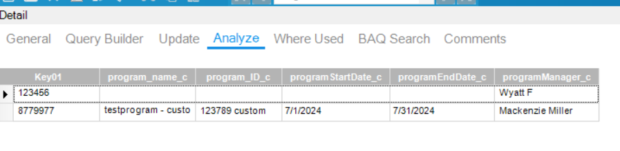

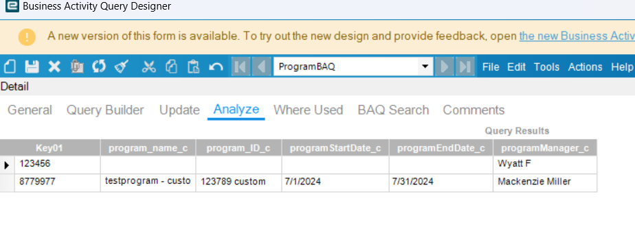

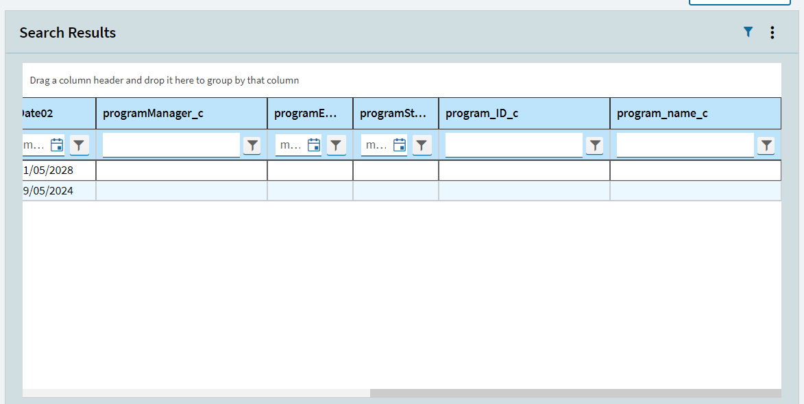

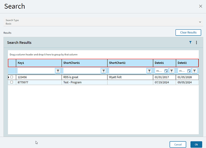

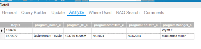

So I would be fine doing this, but for some reason, when I use the searchable textbox the custom fields return empty. I have BAQ’d the table and there is data in those columns, but the search function doesn’t return any values. I have attached some screenshots.
BAQ showing data exists
Search result returning nothing in those columns
The data does show up when I put the data into the prebuilt columns, just my custom ones return empty.

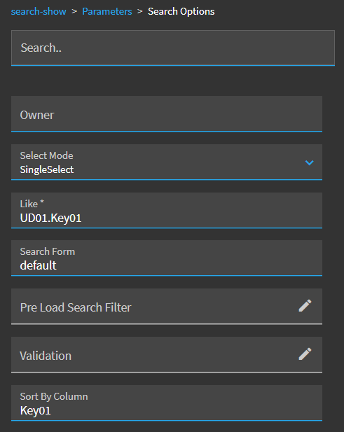

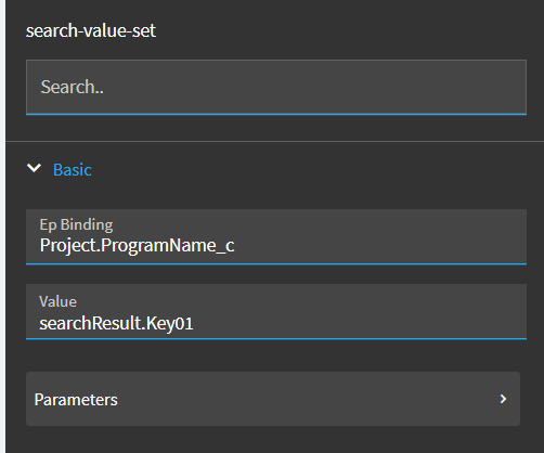

Here is the search I am using currently:
I have tried replacing Key01 with program_ID_c and the search function broke.

I have tried that, but the search data doesn’t return anything in those custom columns even when I have added data to them.

I’d agree that Key01 should always exist, but there’s still the issue where the data isn’t populating in the UD columns, even when I have BAQ’d the custom columns and the data does exist, if you have seen the screenshots where the BAQ has data and the search results yield nothing in those columns

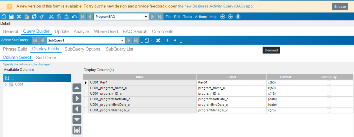

Can you post your BAQ? Maybe that’ll help explain what’s going on.
Sure,
Here is the BAQ display fields
And the result
