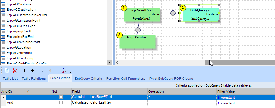

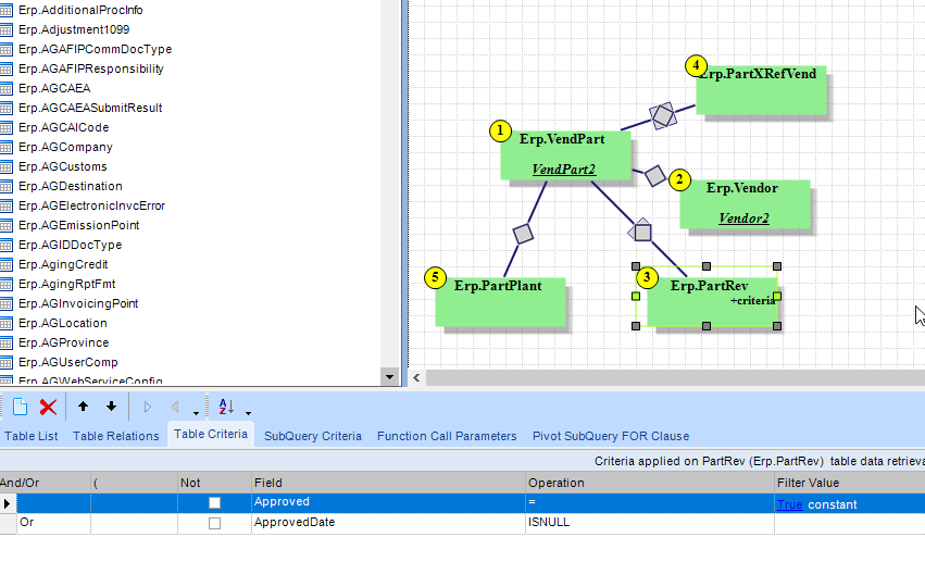

I imagine you’re trying to get the most recent effective date? You can do a subquery and then sort and number the results. Pull the #1 result into your main query.
Calculated field in subquery
ROW_NUMBER() OVER(PARTITION BY VendPart2.VendorNum, VendPart2.PartNum ORDER BY VendPart2.EffectiveDate DESC)
