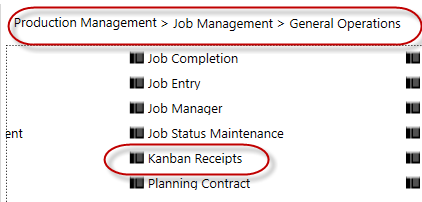

I have used Kanban for things that i just need to backflush material and labor for. Things that are generally made to stock and come from a machine shop.
when you report a kanban quantity is complete you are receiving it into inventory and the system creates a job, backflushes labor and material and completes the job
Interesting! I didn’t know this existed. It will definitely help us out on our simple assemblies, but I’ll have to do some testing in pilot to see if it meets our needs.
