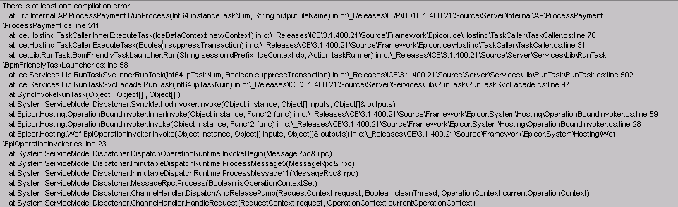

I built it in 10.1.600 and it works great. I move it to 10.1.400 and upon process payments, I get a less than useful:
I did regear the project for 10.1.400 in VS to test for any compile errors that may have occurred due to version differences, but to no avail, VS shows no warnings or errors.
So what’s going on on line 511 of your source file?

It looks like this:
Thats an error in the processpayment.cs (an epicor thing,althought I cant determine the exact line cause I dont have the source):

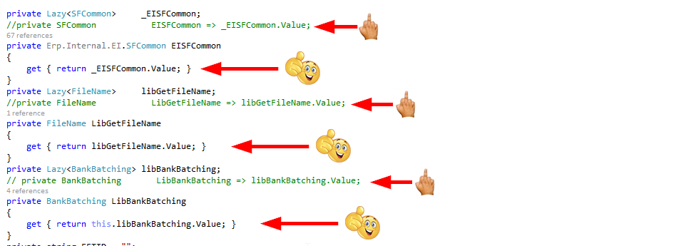

Well… after too long spent I have the answer.
