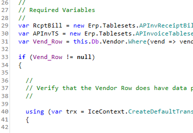

‘CreateNewDtl’ Function doesn’t return properly
var fields = Line.Split('|');
try
// 'out' variables used within Epicor space
string errMess;
string opLocMsg;
decimal grpTotalAmt;
bool requireUserInput;
string opMess;
string opMsgChk;
string opChkRev;
bool GenLedgNum;
bool UpdateRan;
string opDUAMsg;
string glAcctDisp;
string glAcctDesc;
decimal grpTotalInvAmt;
string comp = fields[0].Trim();
string ID = fields[1];
// Required Variables
var RcptBill = new Erp.Tablesets.APInvReceiptBillingTableset();
var APInvTS = new Erp.Tablesets.APInvoiceTableset();
var Vend_Row = this.Db.Vendor.Where(vend => vend.Company == comp && vend.VendorID == ID).FirstOrDefault();
if (Vend_Row != null)
// Verify that the Vendor Row does have data prior to performing actions
using (var trx = IceContext.CreateDefaultTransactionScope())
// Set the vendor number and PO Number for use in multiple
// fields. Run once and store the value
int VendNum = Vend_Row.VendorNum;
int PONum = fields[24] == "" ? 0 : Convert.ToInt32(fields[24].Trim());
// Build context and get services from Epicor to perform
// database operations
var context = Ice.Services.ContextFactory.CreateContext<ErpContext>();
var APInv = ServiceRenderer.GetService<Erp.Contracts.APInvoiceSvcContract>(context);
var GLAcc = ServiceRenderer.GetService<Erp.Contracts.GLAccountSvcContract>(context);
// Get Invoice Details
APInv.GetByID(VendNum, fields[3].Trim());
// Determine if there is a PO Number attached
// to the invoice, if so we can grab details from
// the PO, else we need to populate the fields
// with Vision Data provided
if (PONum != 0)
// Gets all uninvoiced receipts against the PONumber
// and the corresponding receipt lines
APInv.GetAPUninvoicedReceipts(ref RcptBill, VendNum, fields[3].Trim(), PONum);
APInv.GetAPUninvoicedReceiptLines(ref RcptBill, VendNum, "", fields[28].Trim(), false, fields[3].Trim(), PONum); // Believed to be error line; not caught in Exception - FATAL error if failed
// Set the proper Receipt Line = true
// and trigger the row mod to 'U' so
// Epicor knows the value has changed
foreach(var prt in RcptBill.APUninvoicedRcptLines)
if(prt.PackSlip == fields[28].Trim() && prt.PackLine == Convert.ToInt32(fields[29].Trim()))
prt.SelectLine = true;
prt.RowMod = "U";
// attached the selected Receipt Line to the Invoice Detail
APInv.SelectUninvoicedRcptLines(ref RcptBill, VendNum, "", PONum, fields[28].Trim(), false, fields[3].Trim(), false);
// Grabs the rest of the Detail data. Think
// assigned G/L Code, Receipt information, cost, etc.
APInv.InvokeInvoiceSelectedLines(ref RcptBill, out opLocMsg);
} else
// Get new Misc Dtl object with defaulted fields
// then call the ChangePartNum method to bring in details about
// the part if it was within the part table
APInv.GetNewAPInvDtlMiscellaneous(ref APInvTS, VendNum, fields[3].Trim());
APInv.ChangePartNum("Vision NON-PO Part", ref APInvTS);
// Set the description of the part, if nod esscription provided, set
// the value to Vision Part.
APInvTS.APInvDtl[0].Description = fields[33].Trim() == "" ? "Vision Part" : fields[33].Trim();
// Change the quantity and cost with Epicor methods to verify data
// and create other objects such as GL Acct and Tax information
APInv.ChangeVendorQty(Convert.ToDecimal(fields[30].Trim()), ref APInvTS);
APInv.ChangeUnitCost((fields[31].Trim() == "" ? 0.0m : Convert.ToDecimal(fields[31])), ref APInvTS);
// Verify the Vendor and make the final save
APInv.CheckVendorTaxID(fields[1].Trim(), out errMess);
APInv.UpdateMaster(ref APInvTS, GroupID, "APInvDtl", true, false, true, false, out grpTotalAmt, out requireUserInput, out opMess, out opMsgChk, out opChkRev, out GenLedgNum, out UpdateRan, out opDUAMsg);
// Update GL code again due to data-saving needing to taking place
// prior to changing G/L code. Once the data is in DB, we can
// alter the data in the table and resubmit
if (PONum == 0)
// Update the APInvExp table with the correct G/L code and toggle RowMod = U
// for updating
APInvTS.APInvExp[0].GLAccount = $"{fields[9].Trim()}|00|{fields[10].Trim()}";
APInvTS.APInvExp[0].ExpDispGLAcct = $"{fields[9].Trim()}|00|{fields[10].Trim()}";
APInvTS.APInvExp[0].RowMod = "U";
// Perform the same actions on the APInvExpTGLC table
APInvTS.APInvExpTGLC[0].GLAccount = $"{fields[9].Trim()}|00|{fields[10].Trim()}";
APInvTS.APInvExpTGLC[0].SegValue1 = fields[9].Trim();
APInvTS.APInvExpTGLC[0].SegValue2 = "00";
APInvTS.APInvExpTGLC[0].SegValue3 = fields[10].Trim();
APInvTS.APInvExpTGLC[0].RowMod = "U";
// Validate the G/L Account is active and current
GLAcc.ValidateGLAccount("MAIN", $"{fields[9].Trim()}|00|{fields[10].Trim()}", "", "", null, true);
GLAcc.GetGLAcctDispAndDesc("MAIN", $"{fields[9].Trim()}|00|{fields[10].Trim()}", "", false, "", out glAcctDisp, out glAcctDesc);
// Make a save against the APInvExp table
APInv.UpdateMaster(ref APInvTS, GroupID, "APInvExp", false, false, false, true, out grpTotalAmt, out requireUserInput, out opMess, out opMsgChk, out opChkRev, out GenLedgNum, out UpdateRan, out opDUAMsg);
// Complete and close the transaction for
// the next
trx.Complete();
trx.Dispose();
APInv.Dispose();
GLAcc.Dispose();
} // End of using statement
} // end of Vend_Row If-statement
} catch (Exception ex)
TestString = ex.Message;
throw new Exception("There was an error building the Detail", ex);
I believe the issue lands on the GetAPUninvoicedReceiptLines as I threw a catch around it and returned the error (which worked properly) saying that it was an invalid receipt. I would expect that error to be passed through, but it isn’t for some reason. I’ve been testing using the Swagger page and Schedule Function module in Epicor. Any help would be super appreciated! I’ve spent more time than I’d like to admit running through this trying to identify the error and it’s for a SOX compliance action at our company.
