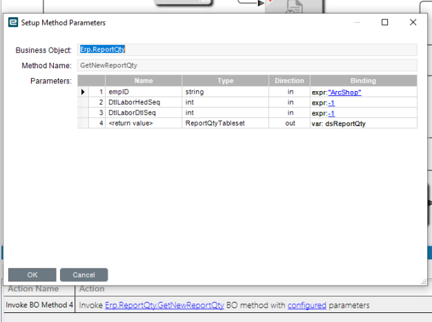

In a function, I’m having an issue with the report quantity widget, just getting a new report qty dataset:
I get the error: “An active Labor Header record is required.”
Detailed error report below.
I’ve checked the company and site configurations and can’t see any glaring differences. The employee is set up the same.
Here’s the trace result from running Report Qty from MES:
<parameter name="empID" type="System.String"><![CDATA[arcshop]]></parameter>
<parameter name="DtlLaborHedSeq" type="System.Int32"><![CDATA[-1]]></parameter>
<parameter name="DtlLaborDtlSeq" type="System.Int32"><![CDATA[-1]]></parameter>
<parameter name="CallContext" type="Ice.Bpm.Context.ContextDataSet">
I tried pulling in a new report quantity widget inside the function but get the same error.
What am I not seeing?
