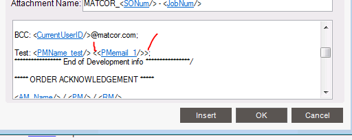

But if I try to build that from fields (say I have UD05.Char01 as the name and UD05.Char02 as the email address), I enter the following in the email template
<PM_name> <<PM_email>>;
The bold parts are the “Inserted fields”. Note that I put the inserted field PM_email in a set of brackets, and followed by a semicolon.
But that renders as
Without the brackets, it renders ok
Trying HTML codes (&lt; and &gt;) for < and > yields
Test: JAYSON PACHECO &lt;jpacheco@matcor.com&gt;;
Any way to use &lt; and &gt; with inserted fields?
Some special escape character perhaps?
BTW - manually adding < and > characters in the template editor messes up the “inserts”
for example, creating the following (PMEmail is included in manually entered brackets)
<PMName> <<PMEmail>>;
