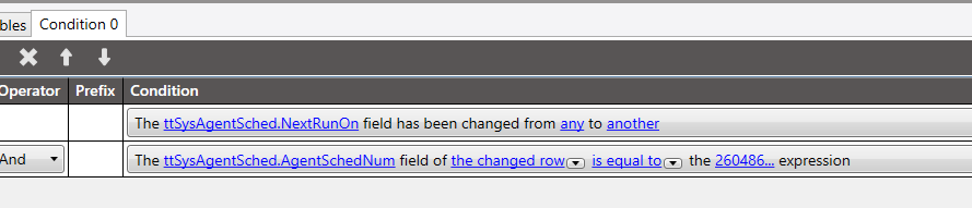

I’m currently using Kinetic 2023.2.6 SAAS. Following a recent update, the Data directive BPM on SysAgentSched has ceased functioning. I had previously configured daily notification emails and reports within these BPMs, utilizing report data generated from a BAQ.
BPM had a basic condition set up to filter the schedule number and check whether the NextRun field has been updated and which is followed by my custom code with email configuration.
Are you using any custom code widgets or function calls? We had an issue upgrading from 10.2.700 to 2023.1 with the custom code for sending emails. It also looks like you have the schedule ID set in that condition. Is it possible your schedule IDs changed on the update? You can look at those in the System Agent module.
I do have custom code where email template is defined. Agent ID isn’t changed after the update. I tried creating new schedules and even tried clipping to another schedule where I have reports with SRRS routing. The problem seems BP directives skips the calls from this table. Also noticed that Kinetic version of data directives is not showing any ice schema tables.
