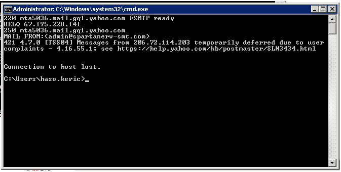

We had a case where GoDaddy blocked NS, the only way one could ever find out is to run something on the same ip address where NS is sending emails out-from (telnet for example).
Otherwise you may never know if their internal ip is blocked.
