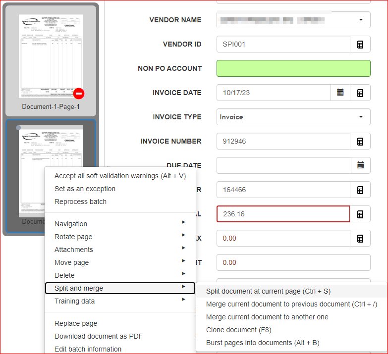

So if you don’t want to maintain yet another model you can use the split function in IDC and then restart the batch. I think in the newer version of IDC they even have it so that when you split it, it re-does the capture and verify.
IMO training another model on classification is more work sometimes than it’s worth.

@utaylor I’m drawing a blank on this - I checked in IDC and can’t find the SPLIT as it applies to documents, only in the field expressions. Can you elaborate and help an old man’s failing memory :wink: ?
It is when you are training. I didn’t remember either, but found it last night.
Thansk! It’s the only place I didn’t look! But that isn’t automatic, only manual. I was hoping maybe we found something that would happen at the Email Input engine.

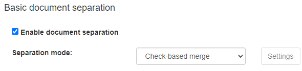

@MikeGross Were you able to figure anything out? I’ve tried checking the “Enable document separation” box, but it doesn’t seem to be learning (maybe I just haven’t trained enough). Wondering if there is another spot to work with Document Separation besides here:
Or maybe I’m not supposed to be using “Check-based merge”? The other two options didn’t make much sense (“1 Document = 1 File” and “Fixed page count per document”).

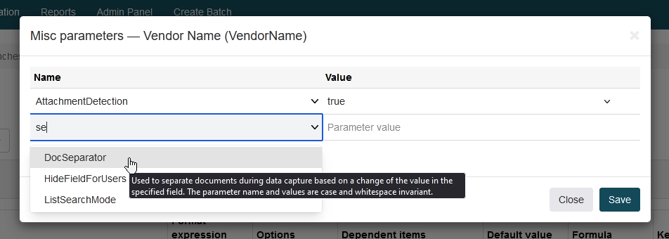

It’s a misc parameter in the document form definition. So if you want the document to be separated on a change in invoice number, add a misc parameter on the invoice number field, and make that a doc separator.
Thanks @Banderson !
