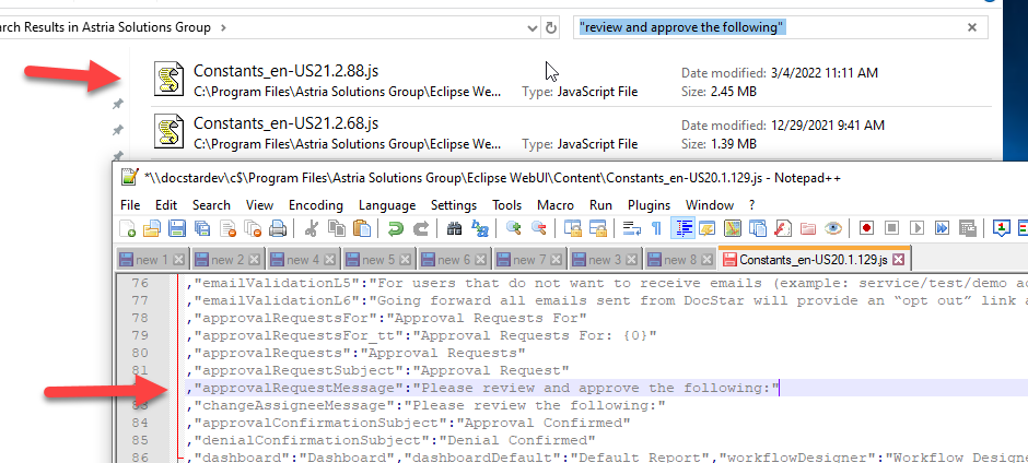

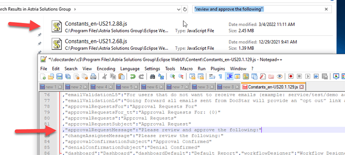

I did find this though. It looks like we cannot change it in any drastic way, as it seems to be one of the ‘global constants’ the system uses.
Find the version appropriate Constatns_en_US21.2.88.js files (where that last bit is your version) in the C:\Program Files\Astria Solutions Group\Eclipse WebUI\Content directory.
The second line is really a list of like 1000 constants and in there is the string we’re looking for. I have NOT edited and tested this hypothesis, but I might when I get a minute.

So yes, the file is all there is right now. The Workflow task that submits a workflow notification for approval submits the email as an ‘text/html’ email format with that Constant-String and the URL after it.
As for the Unsubscribe link - in the Approval task - there is a checkbox to override user preferences - this will send the approval email to those who have clicked the unsubscribe link.
Good information Mike, thanks for updating us.
@utaylor So it looks like the email that we receive is that Constant + the Workflow/Invoice URL + the Unsubscribe URL + the closing tags… I think the core code does the concatenation and stuff before it submits to the configured SMTP server.
So I was playing with it - and I don’t know of a way (yet) to save HTML code as the Constant and not break the core code process of sending the email. We certainly cannot append anything after the invoice/unsub URLs, so signatures are out of the question at the moment. Best we could do would be some basic HTML without the head/body tags and see if the code just inserts our Constant “as is” and we get a nice HTML formatted email.

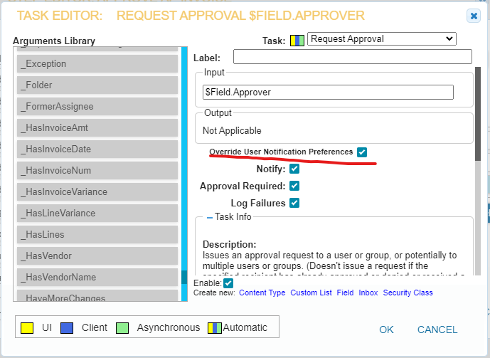

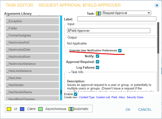

Is this what you are refering to for the override:
We have it checked but it seems to be ignored.
Yep - that checkbox. It doesn’t prevent the UnSub link from appearing in the emails, just that this Approval Notification task will ignore any unsub requests to the ‘Approval Notifications’

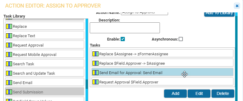

E-mail capabilities from ECM WF are more robust with the ‘Send Email’ task, but that’s not seamlessly triggered to send to an approver for an approval request. I have set up a number of ‘Send Email’ tasks for non-approval request notifications and have been pleased with the ECM WF functionality. An example includes a Duplicate AP Invoice notification e-mail when ECM detects that a new invoice from IDC already exists in Accounts Payable within our Dynamics GP financials system.
I would also be interested to hear if – and how – anyone has set up request approval e-mail notifications using the ‘Send Email’ task. In other words, have you shut off the standard (seeded) notification by unchecking the ‘Request Approval’ step’s Notify checkbox . . . and instead, set up a ‘Send Email’ task to send your own custom approval request notification e-mail?
Eric - could you add the Send Email task right before the 'Request Approval" task - and set the Request Approval task to NOT Notify? That would cause the email to go out, with the proper link - AND cause the workflow to stop at the approval task.
Would that work?
Yes, Mike. I think that would work!
