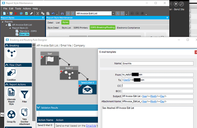

By insanely popular demand, for every Breaking and Routing SSRS Report Style that I create, my users always want me to create one called “Email Me” which will email the report to the generating user.
In the Email Template, I right click and use a System Constant called “UserID” which pulls the current User’s Epicor ID and strings it with @ourdomain.com. So if I run the report and use the Email Me style, it will send an email to leeb@ourdomain.com.
Caveat: This only works if your employees’ Epicor UserID (leeb) is the same as your employees’ email address prefix (leeb@ourdomain.com), otherwise, you’d could probably macgyver a map by setting up SMTP aliases in your email system.
Lee - thanks for that info. I was thinking the same thing but didn’t know if would take the mashup of field+text. Good to know that it will. As for my users, most of them match but some do not. I’ll get some aliases set up and I’m on my way!

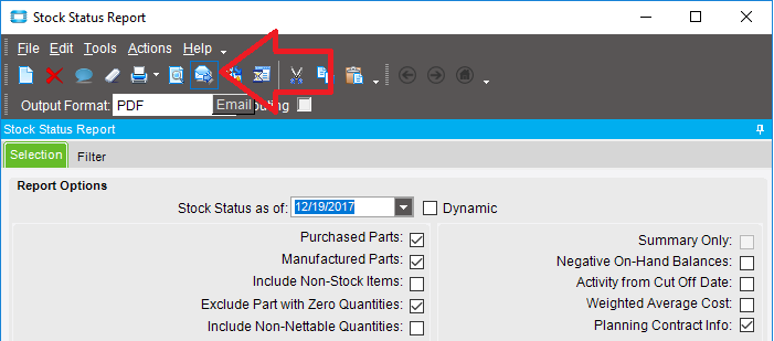

Hmmm I haven’t had any issues getting emails to send. If you’re not getting any errors in Epicor, maybe you’re getting errors on the SMTP Server? I’d double check Company Maintenance >> Email and Reporting >> SMTP Server/Port/Authentication just to be sure.
One quick test to rule out Epicor to SMTP issues would be to use the Email function in any Report (not from a BPM, but from the actual Email Button). If it sends okay from here, then I would expect it should send from APR with no additional configuration. If it doesn’t send, then maybe you have an issue at the SMTP server.
