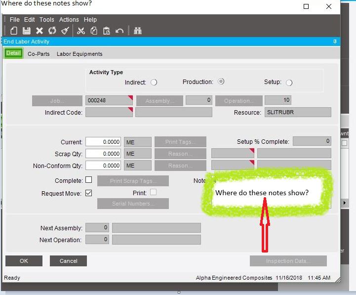

Our operators want to know if they can input notes / comments on a running job that subsequent operators can see??

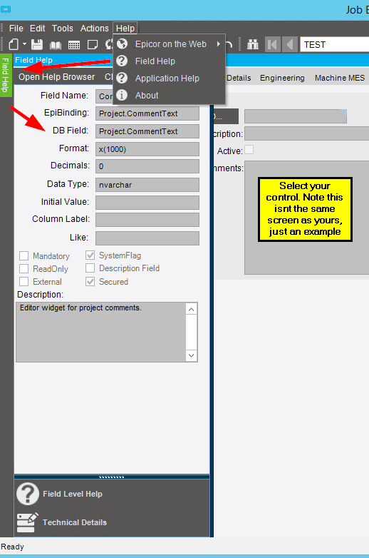

You can see what Table\field those are being stored to by using Field Help
They show up in the time and expense entry screen, so they are not a running dialog on the operation.
You should be able to add a field onto the JobOper table or use CommentText if it is not used and then read/update it from End labor. We do that with a field on JobHead and it was a small customization.

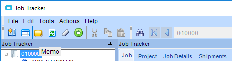

Another option is to use a Memo.
Which is great for notes but @Robert_Hartshorn is correct. If you want to do analysis. Put it in a field.
