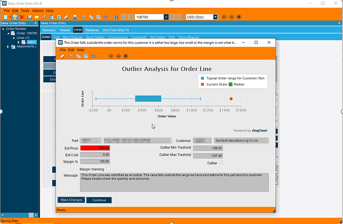

Attached is the BAQ that will Calculate the IQR OUTLIER for a Sales Order
MarginCostStatChecker.baq (48.4 KB)
This BAQ Calculates Outlier based on Interquartile Range and allows you to present this information to a user like this
Here’s how to call the above BAQ from a BPM
