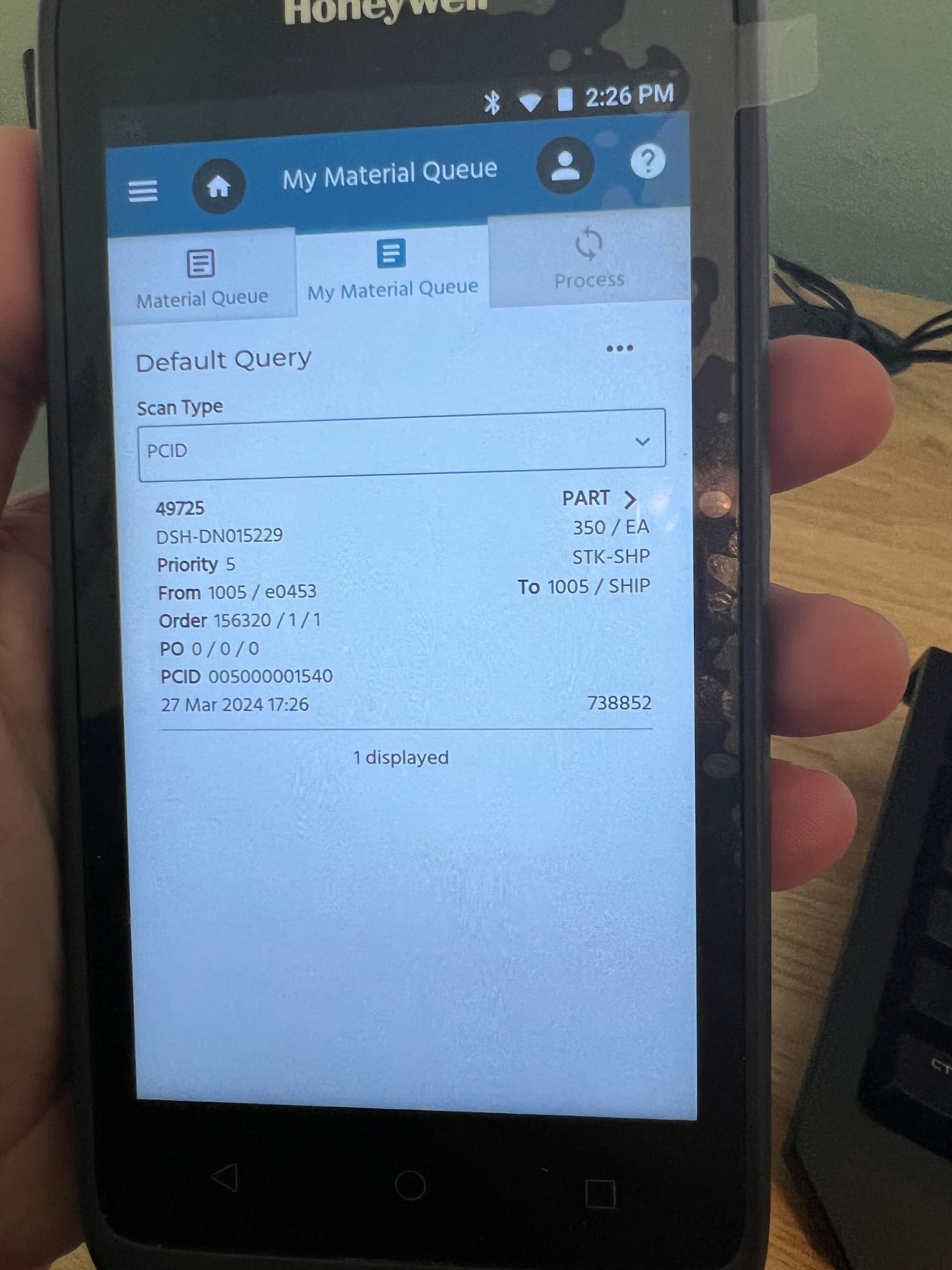

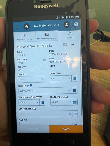

Anyone using EMWW know if there’s a way to force Scan Validation of PCID on Material Queue Processing?
For example if we allocate by PCID the Hand held already gives you the material queue with a pre populated from PCID and all you got to do is click save.

Right the screen says get PCID
12312423526
I want to make sure they grab the right one off the floor. So I want them to scan the one they grabbed off the floor and have it “confirm” it matches 12312423526

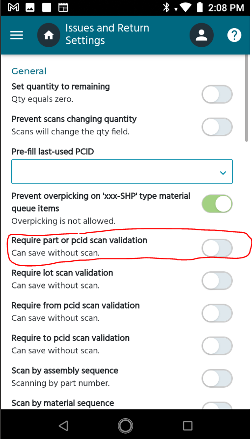

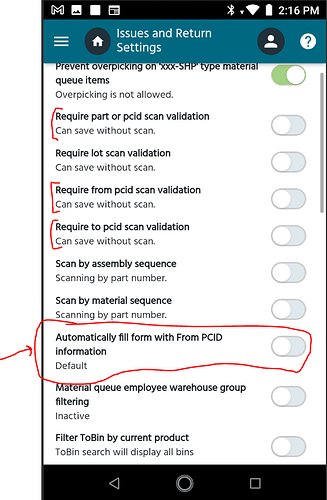

I think this is what you are looking for (or the option two or three options below the one I circled):
This one looks interesting too:
That’s for issue and return though not for MTL Queue but I will try it.

Material Queue says as shown below PICK: 350 from PCID: 0050000001540
Now you are a tired forklift driver with poor vision, you roll up to bin E0453 there’s a handful of pallets, you grab one that looks “right” and you go on your way. You click save on the transaction…
Turns out you picked the wrong pallet… that’s what validation scans are for, it prevents errors.
This was the ticket @BKen turning on FROM SCAN validation
There is a Scan Validation section of Settings:
There are many options for requiring PCID scan validations.

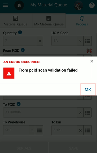

They need to enable “Require from PCID scan validation” option in Settings > Scan Validation – Process Issue or Return section.
This enables the red barcode icon above the From PCID field and prevents processing the transaction if PCID is not scanned
Is there a way to require that the originally indicated PCID is the one that is scanned? In some cases we have requirements that they pick a specific PCID and that is determined in the material queue (for FIFO reasons). From our testing, they are require to scan a PCID, but it can be a different PCID, and the scan will change the number in the field and still come back with a green check mark.
I think that would need to be a BPM. This is what I was getting at originally, not picking from the allocated PCID isn’t strictly incorrect according to Epicor so I don’t know how it would know to throw up an error out of the box.
