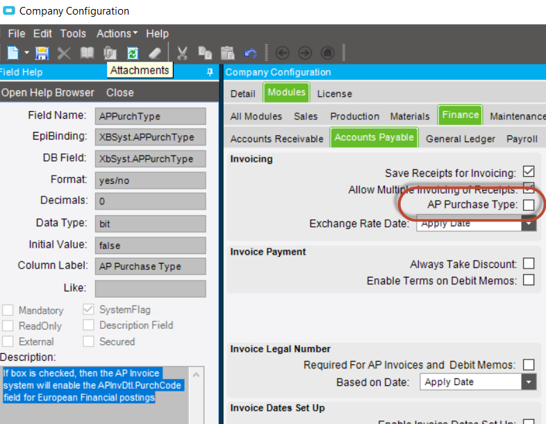

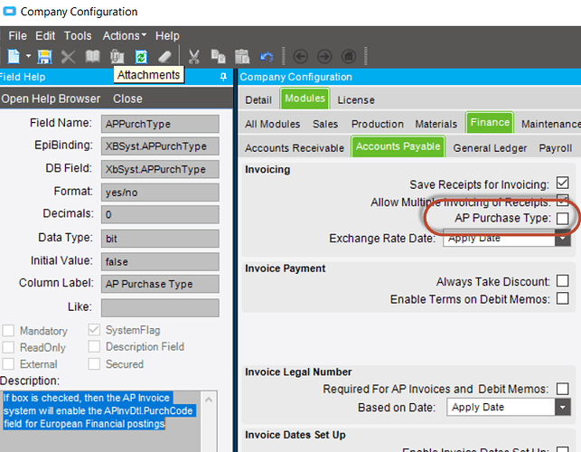

can you still do field help in kinetic?

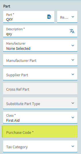

Yes. But it is in 10.2.500. It is called Purchase Code (but is called AP Purchase Type in Company Configuration).
What Form are you in on that screen shot. i thought it was a kinetic screen.

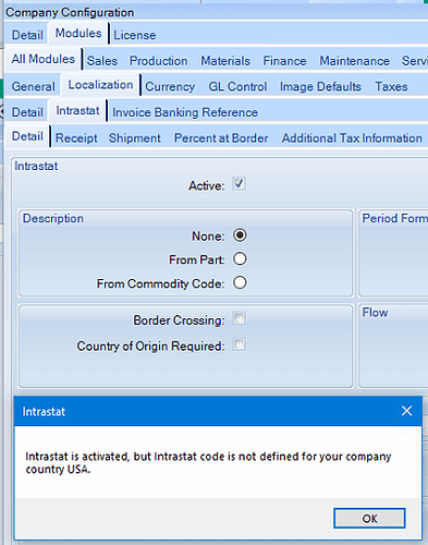

@jkane I think this only applies to EU countries in E10. In E9 we had purchase types in use. In E10 they didn’t work. A user called support and told him where in company config to turn them on, so he sent the KB EpicCare Login - EpicCare on how to make them active to me. I then found out it was EU only and did not turn them on. If you search intrastrat on EpicCare there are even articles about how to exclude the UK after Brexit.
I got the error below tring to enable in our test environment.
