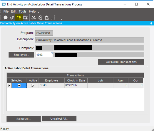

Have an issue with a labor detail and I need to get rid of it but I can’t cause it says it’s an active transaction.
In pilot I was able to delete it using “End activity on active labor detail.” But in production, there is no End activity on active labor detail.
Any ideas?

ubaq to make active false

You ran this from Conversion Workbench? Because it should definitely be there under User Run Conversions.

LOL. That conversion is there. I have been doing this for so long with my baq I didn’t even look.

I’m betting someone added that conversion to the menu in pilot.
You can do that if you need it often @carguy

Ended up doing this and it worked! Tried it before you posted and forgot to update the post.

Was right in the menu in pilot. Couldn’t find conversion workbench. Never had to run it. My guess is, we don’t have it because we’re in public cloud. But maybe I’m wrong.
Either way I made a ubaq and changed from activetransaction to false. Then deleted with no issue.
I first tried to do it within the REST api but it didn’t work. No idea why.
It’s resolved though.

carguy:
You have it.
Don’t run stuff in there without research though
