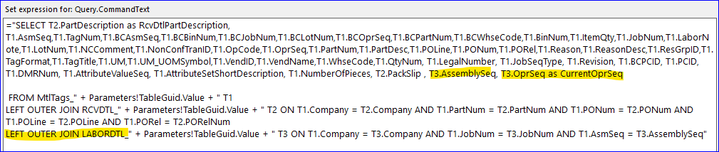

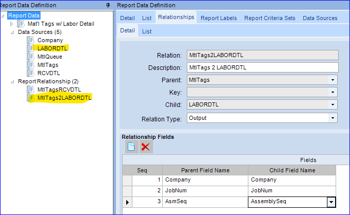

What if you tried to add LaborDtl as a relationship in the RDD?
The active LaborDtl record would have your JobNum, AssemblySeq, & OprSeq.

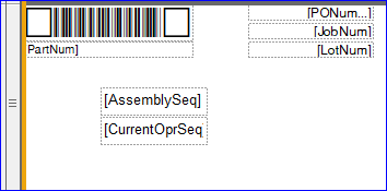

Give that a shot. I was able to add that relationship in the RDD, add the below to my query:

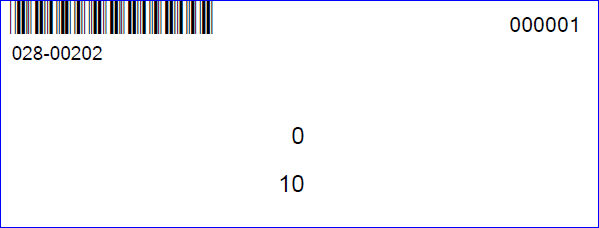

Was able to get this sloppily thrown onto my label printed from End Activity:
I was currently ending activity on Assembly 0, Op 10:
You’ll need to test if that will work across various operation sequences, but it seems to work at first glance.
Mr. David: Thank you so much for the suggestion – for a minute there I thought you had the answer.
However, my only concern is that we would be joining by the Job number and ASM and NOT the Operation Seq.
I believe if you do not have AMM the Sequence number is the same as the operation you ending activity on. However, with AMM the Sequence number is the Next JobOprSeq.
