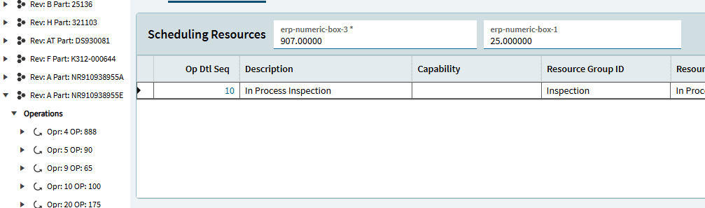

Just curious, I created a BAQ and then tried to tie that to a box.
In this picture the first box is the resource ID and the second is the cost.
It works when selecting Operation 10. Then the moment I select Operation 20, it doesn’t change. I stays with the first operation that was selected.
Is there a way to get it to change?
