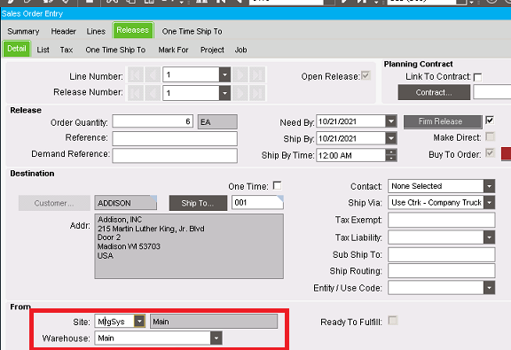

Wonder if you can change the “From” information on your SO Release(s)
and if that would resolve everything for you?
No, the dropdown only shows the current plant.
