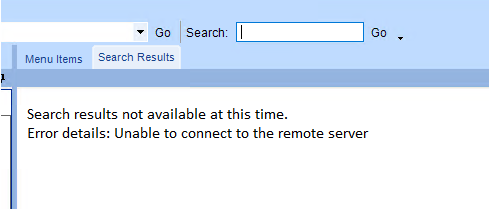

Having an issue that users are unable to use/connect to enterprise search. If a user tries searching for something on their desktop they get the error ‘unable to connect to the remote server’ (1st screenshot below) If I try opening a web browser up on the client and just type in the URL, it will load the webpage but when I type a customer name in and try to search I get a 'unable to authenticate the user identity (400) error (2nd screenshot below). Enterprise search will work on the Appserver itself. I have tried redeploying Ent. Search via the EAC, I’ve tried changing the permissions in IIS to match the settings for Epicor Help and EWA that do work on clients and nothing has worked. Also tried updating permissions in SQL for the account being used for the app pool to ensure it has access to the search index database and the actual Live database. Seems odd as these usually go pretty smooth. I did not do the initial install/setup so I’m not sure if it has never worked, I suspect that is the case though. I’m pretty confident this has to be some kind of a windows permission problem. Any ideas or suggestions is appreciated.

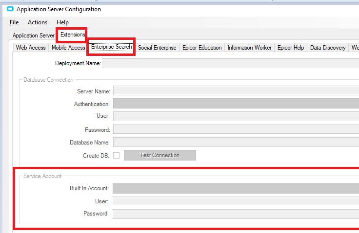

My 2nd question would be, what do you guys put in the service account section under the appserver config menu? The Epicor Install docs don’t even mention this section. Use a custom account or Local System? I’m assuming use ‘Custom acct’ and then use that same user for the app pool and the epicor search indexer windows service? If that is true, then that is how I have this environment setup and ES still isn’t accessible to clients.

I’m surprised no one has run into this. I have noticed that 10.0 did not have the Service account option like 10.1 and 10.2 do, but the documents for 10.1. and 10.2 do not mention this section and I assume that’s because Epicor reused part of the 10.0 doc.

I am able to get information into those boxes, but I cant start the indexer
Ended up creating a domain admin account named ‘EpicAdmin’. used that for the app pool user and also the windows indexer service.
I had tried that as well, but it did not work but in my case it turns out that I had multiple IIS certificates and for some reasons that caused an issue there. After removing the cert, it seems to have fixed it. My pools are either set to LocalSystem or ApplicationPoolIdentity.
Also, potentially related, under services Epicore ICE Task Agent is set to a domain admin account and Epicor Search Indexer is set to Automatic and NT Authority\System.
