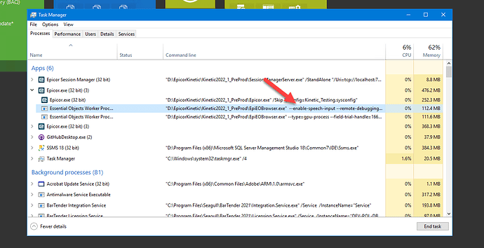

What’s with the enable speech-input???
Is there a way to just turn this off we are only using classic UI at the moment (with Kinetic Home Page). In this instance I was launching from with the modern shell.
Just guessing, but that’s probably the little microphone you can click and give speech input.
I don’t know if there is a place to turn off those options. Check the client .sysconfig file.

sysconfig
<EOBrowser>
<!-- Sets the extra command line arguments for EO Browser -->
<ExtraCommandLines value=" --use-simple-cache-backend=on" />
<LogPath value="C:\Users\shall-admin\AppData\Roaming\epicor\log" />
<LogEnabled value="false" />
</EOBrowser>
https://www.essentialobjects.com/doc/webbrowser/overview.html
Nothing sticks out in detail at the moment, and little reference to it in Epicare apart from
https://epiccare.epicor.com/epiccare?id=epiccare_kb_article&sys_id=KB0126091
Based on that I’m assuming you could put in --enable-speech-input=off
Something on the EO site it talks about a remote debugging tool also…
