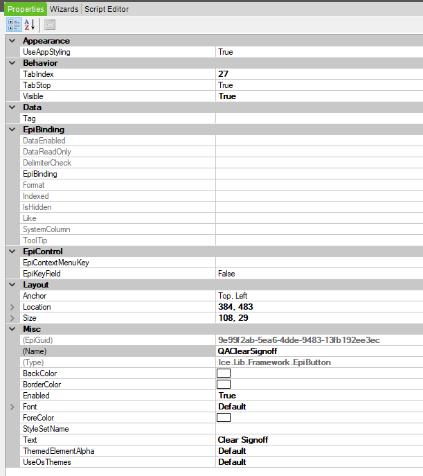

What I would like to see are some more detailed steps in order to get an epibutton to fire a BPM. I have my button created (currently unbound as it’s an epibutton so assuming no binding is required?). I created a post processing method directive for custom update using the condition of my button field is changed on the specified row. Please advise if another condition type should be used or how to point to my specific epibutton in the BPM. Following the condition I want to clear two different fields so the “Set Field” option will work for me as would the “Send Email”.

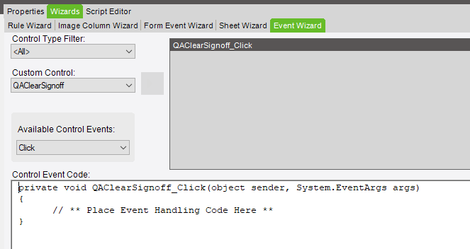

Once the Method Directive (post processing for update or custom update) has been created this is where I get lost. Not sure where to go in the customization window to point my epibutton to the Method Directive. My guess is Form Event Wizard should be used for my epibutton on a click and then somehow put in the code referencing the Method Directive, but again this is where I get lost and could use some help.

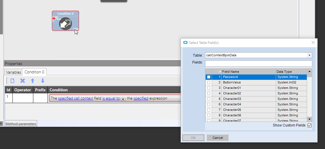

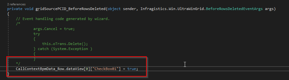

So set something the CallContextBPM like this.
Then in your BPM you have call context variables that you can use to filter.
Ok I will give this a try. When using an epibutton instead of the example you provided of CheckBox01, would I bind my epibutton to the Call Context BPM Data field of Checkbox01 in customization properties or how is this connection made if not there?
With your epi button field, you set the BPM context variable to true, then you have to trigger and update somehow. (change something trivial and save in code). Then the BPM will fire, and you have a condition so it only completes when that BPM context is true. Don’t forget in your BPM to set that variable back to false after you do what you want to do.

I think you then mean to use the Event Wizard to do a control type filter on the Epibutton of my custom control (QAClearSignoff in my case) and the available control event of click to run the code you listed above setting “CheckBox01” = true.
When CheckBox01 = true has been set the BPM can then fire per the condition and then execute subsequent actions.

As far as the specifics you are asking about, you don’t need to bind the button to anything. A button doesn’t display anything, so the only reason to bind it to anything is for something like row rules. Once you make the button, you can use the wizard to create a button event for you. This gives you an empty method to put whatever code you want into that that method that will fire when you click it. So what I would probably do is change your new checkbox, then add an oTrans.Update() and it should trigger your update method. See the post below about using oTrans.Update()
