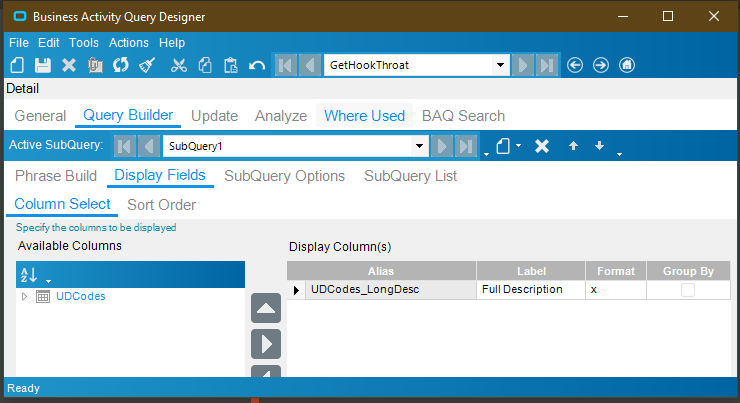

I believe this has been an issue forever, I’ve certainly seen it in since early E9.
Set a manual width, problem solved?
Try setting the format for the UDCodes_LongDesc in your BAQ to x - instead of x(xxx). Then your dropdown will follow the width of your control.

Make the format “x” in the Display Fields.

try changing all of them to x, not just calculated display.

if you have the format set to X the drop down menu is whatever size the control is. Have you resized the control?
