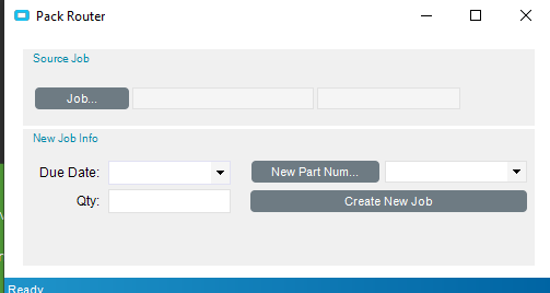

The form I am customizing is is based on the UD01 form. I have hidden everything on the standard UD01 screen and started from a completely blank slate:
This customization is intended to be a screen where users can kick off a process rather than store data so I don’t want anything stored in any UD table.
