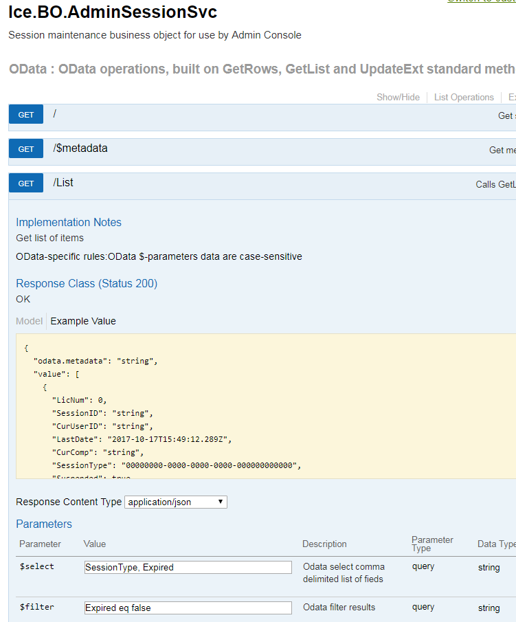

The problem you will have with a db query is that the license data is cached in the app servers themselves, not the database. There is a background task to flush session to db or do UDP peer to peer broadcasting, etc for how you want to manage state on your servers. Luckily, the SessionTypes are easy to query against the REST API and kick with curl.
You can look at the Session List like you would in Admin Console via Ice.BO.AdminSessionSvc/List
I am filtering to just active sessions and their ‘SessionType’ (more in a second)
This will give you the collection of Sessions and their attributes. Next, you need to translate those Guids to their license equivalents. You can decompile Epicor.ServiceModel for those constants or I can build a list if you need.
Next, call this via curl as the example describes. Place that curl command in Windows Task Scheduler and have a dump done every hour or whatever.

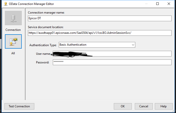

Just to be clear, I’m using the REST services - just accessing them from SSIS. No Epicor table access here…
Create an OData Connection manager (in this case to my Epicor dedicated Tenancy REST Service. We want the AdminSessionSvc). Use your credentials you’ve previously set up for running REST queries :wink:
