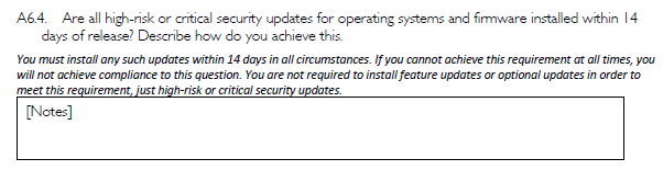

Hi cyber essentials doesn’t determine 14 days. Iso 27001 doesn’t necessarily determine that.
Cyber Essentials clearly states “14 days in all circumstances” actually… it’s there in black and white.
The interpretation is key though I guess - my assessor has interpreted it that the latest Windows 10 build is what is required on this question, but the point raised here about build 1909 being fine as long as all patches for that version are applied also stands up to scrutiny in my eyes. With 20H2 build released, I would say that 1903 is now 3 versions old and therefore “too old” in my eyes.
It also applies to Mobile Phones - we primarily use iOS devices. The patching there is different. If you’re on iOS 13.7, the next thing that the software update client on the device will show you is iOS 14.0. So, you can’t still be “current” with all patches applied if you’re on iOS 13, the only option is iOS 14. But, installing a major release like that in the first 14 days of release by Apple could have issues.
It’s difficult isn’t it, balancing security with functionality and business continuity/disruption.
Hi mark, um. I think I will just leave as it is.
I’m interested to know what other people are doing, and I’m all ears. I’d appreciate your thoughts on the text above.
High Risk and Critical are the key words. That would be what @EarlGrei was alluding to. A major release is not considered a high risk or critical security update. MS will still shunt off critical updates even to older, supported versions, of Windows if they too exhibit a security vulnerability. Major release will come with feature and functionality updates specifically. Any security updates would be retroactive.
