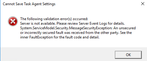

Getting an error message. Application Server version has not been verified.
Needed the Live environment data to put restored to the Pilot to do some testing. Restored live to pilot and now getting that error when trying to start the app pool.

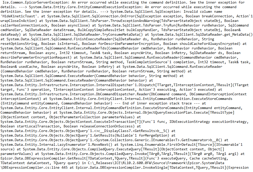

Two errors…
so did you review Event log for details? what is there?
Not sure what this means
This means that SQL server does not have table column it is asked for.

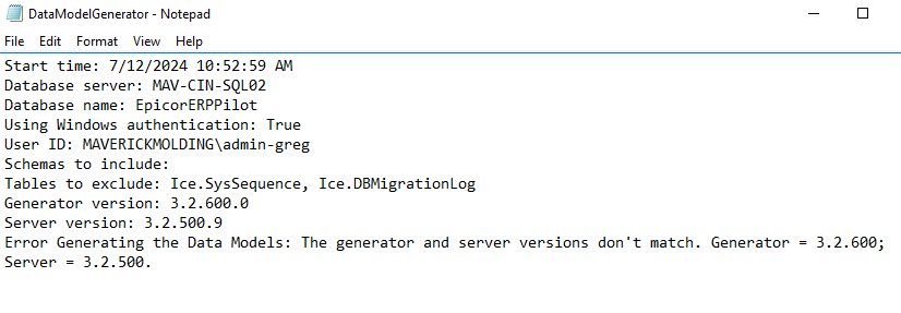

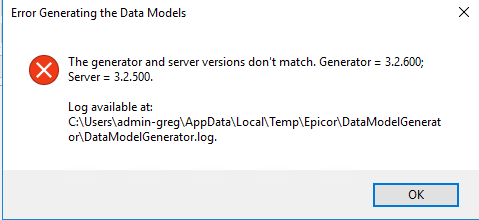

Most probably your datamodel is out of sync. Try to regen it in the admin console.

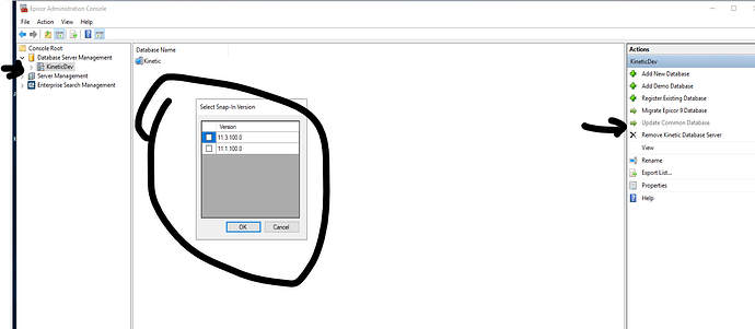

Tried that and received.
This is from the log.

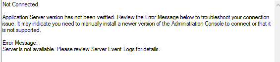

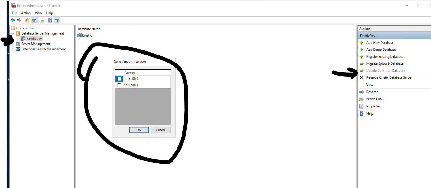

I had removed the app server as well as the server mgmt and cannot get it added back.
any ideas?
Looks like there are two versions on the server
3.2.600.0
and
3.2.500.9

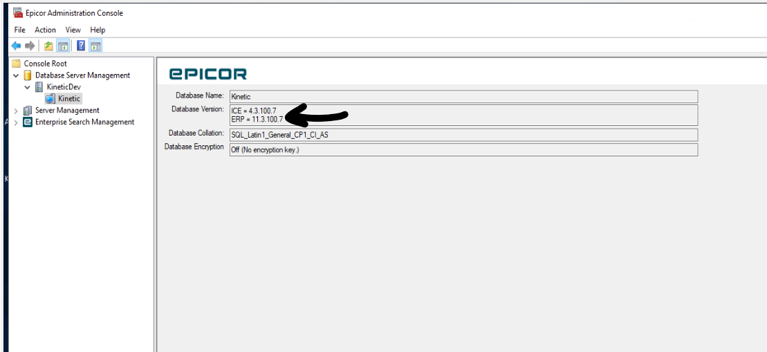

What does the ICE and ERP versions look like in Production and Pilot?
