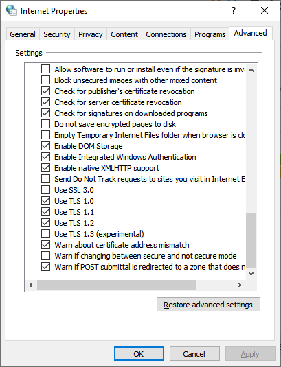

Our test environment is set to “https://avatax.avalara.net/”. I was reading about a test sandbox account that you could create with Avalara, but it was expired now. ![]()
You may want to contact your rep. I don’t know how the sandbox works. I didn’t know something could expire.
But yeah, in short, if your test epicor server is set up like your live one in terms of TLS you should be able to test that 1.2 is working by trying out avalara sandbox.
