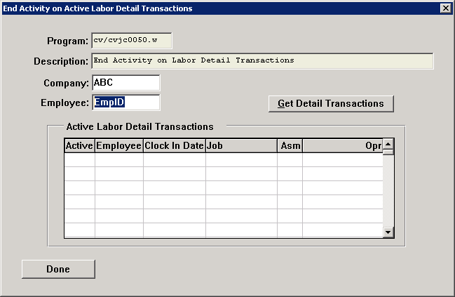

Can you try opening up Admin Tools and run Database Conversion 8920 - End Activity on Labor Detail Transactions and see if the user that reports the Labor Activity against this job still has an Active Trans against it?
If so then I believe you would want to change the Active value to “NO” and click Done and that would release the locked record. And then you would want to be sure to run Database Conversion 8930 - End Activity on Labor Header Transactions and change any record that comes up for that Job to a “NO” as well… we would usually have to run these Conversions whenever someone forgot to clock out of a job and it just sat out there overnight.
So the job is not showing as active transaction. Its shows approved until I click edit. When we had the clock out issue about a couple hours ago. I did manage to clock out which left that one job open. So I did what you said but back then and made it not an active transaction and then I ran a baq which let me change the status to Approved. Then after that I can click edit to edit but still same issue it freezes.
