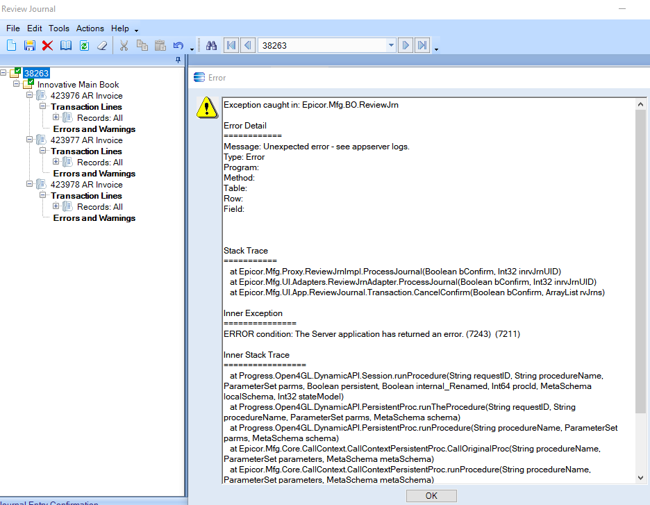

Thanks for the input. I think we have a minor customization of the posting rules, there but nothing that I can’t re-work. I tried loading the standard posting rules, and ran into the same issue. I tried manually reviewing the entries in the review Journal, and they validate in there, but when I go to post the Review Journal, it gives another error and says to check the app servers. When I look in there, no logging is present. My next step is to up the logging level on the app server to Verbose (it’s error only right now) and see if that provides more clues. I’ve never had an invoice get this stuck.

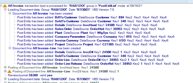

here’s a screen shot of the PE log for the “Edit List” posting mode:

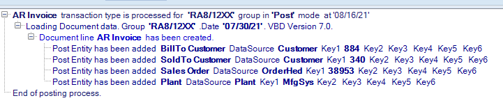

and here’s a picture of the PE log for the “Post” Posting mode, it’s like the post rules don’t find the “Details” section which contains the InvcHead info and that ends up causing the process to stop.
