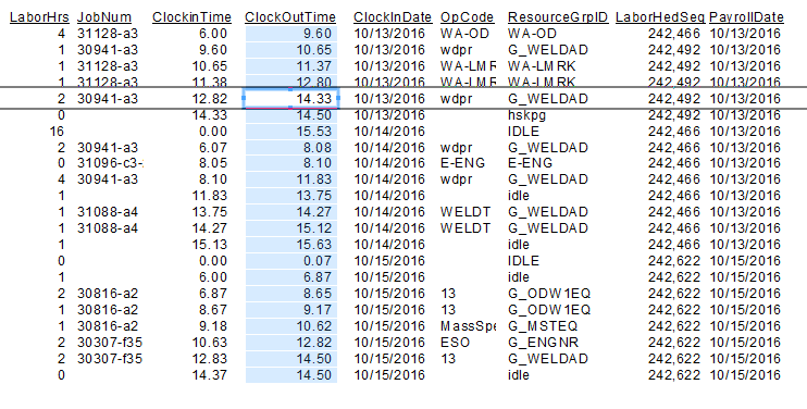

I would verify that the person clocked out for the day. You have documented that they ended their activity. If you can do a BAQ of those transactions, display the “LaborHedSeq” field. If they are all the same LaborHedSeq, the employee did not successfully clock out.
Allen, I just looked at the LaborHedSeq field in the data and they are different even though the Payroll Date stayed the same so I’m guessing that means they successfully clocked out (see pic below). Anything else you think I could check…
Two possibilities come to mind.
The first is that the employee immediately clocked in again after clocking
out on October 13th. It makes sense with the idle time. (14.50 + 15.53
-24.00 = 6.03, approximate time (s)he started a new activity. The
additional idle time can be accounted for by small gaps between
activities.) This could be verified by examining the actual clock in time
on the header record for LaborHedSeq = 242,466. The field can be edited in
Time & Expense entry but it is good practice to not change it.
The second would be that someone accidentally changed the PayrollDate in
Time and Expense Entry. That field can be edited. You could temporarily
turn on logging for this field until the situation is resolved.
