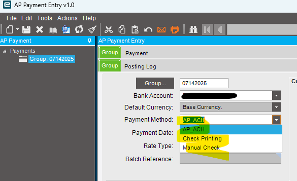

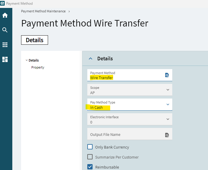

I have added payment method
when i used payment entry and trying to select WireTransfer but i didn’t get option why ?
