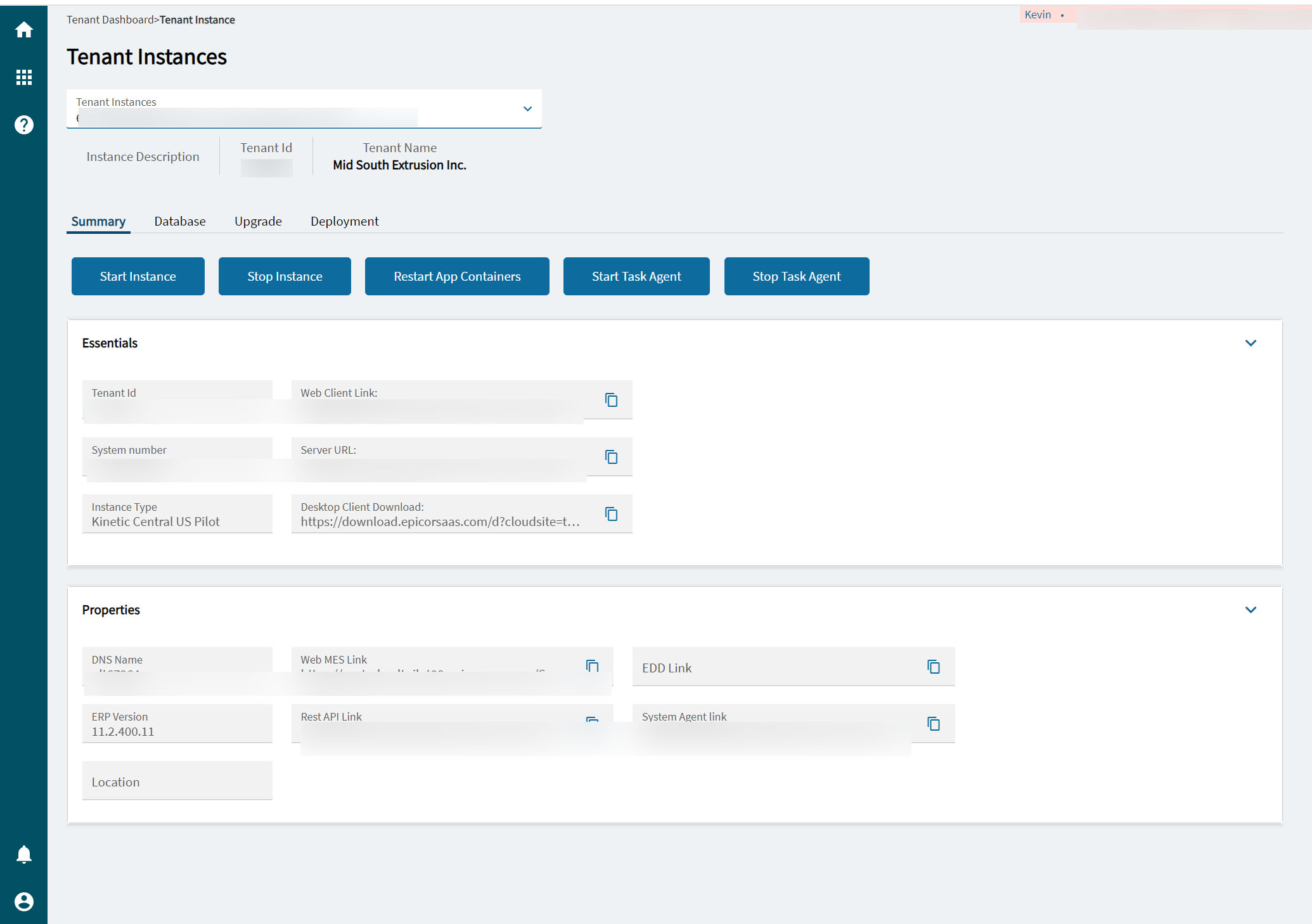

It’s located here:
Black Hole Nsf GIF by GIPHY News
Is that an AKS cluster spinning up?
If you are Epicor SaaS hosted, then you do not have access to the Admin Console. Restarting appservers, regenerating data models, things of that nature can only be done by Cloud Support.
For now. That feature is coming soon.
