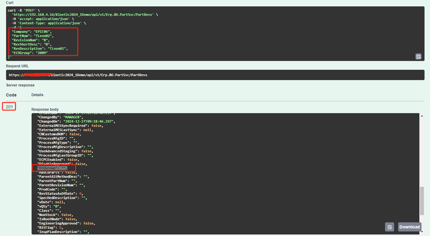

I am facing an issue when using the Epicor API to POST data. Specifically, I found that the ECO Group field cannot be successfully POSTed. What could be causing this issue, and is there any way to resolve it?
Is it possible to set a default value for the ECO Group when creating a new Part Revision in Epicor? It seems that the value cannot be input directly and requires manual linking. However, I would like to eliminate the need for this manual linking step. How can this be achieved?

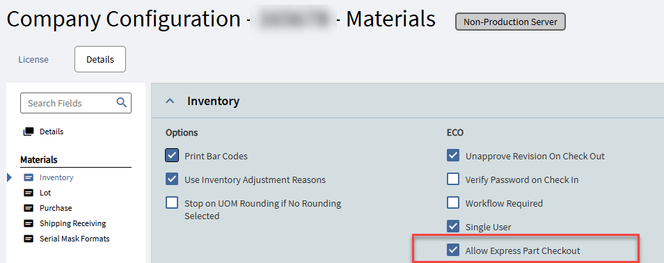

You may want to check out allowing Express Checkout in Company configuration
Many customers work this way.
It will then assign the revision to a group based on the userID.
I want to import a Part BOM into Epicor Kinetic via API instead of using DMT. Currently, I’ve run into an issue where it seems necessary to use EngWorkBench to establish subassemblies for Parts. To do this, I need to associate a Part with an ECO Group, but I’m facing difficulties achieving this.
Here’s what I’ve tried so far:
1.Using Erp.BO.PartSvc/PartRecs API:
2.Using Erp.BO.EngWorkBenchSvc/ECORevs API:
  • I attempted to POST the GroupID (representing the ECO Group) using this API. However, I received the following error:
    “ECORev cannot be created.”
The Problem: To create a BOM structure, I need to link the Part with an ECO Group so that it can be used in EngWorkBench. Without this link, I am unable to establish the BOM hierarchy. Neither of the APIs I’ve tried (PartSvc/PartRecs or EngWorkBenchSvc/ECORevs) has allowed me to accomplish this.
My Goal:
I need to find a way to POST and associate a Part with an ECO Group using API.
Alternatively, I’d like to know if there’s another API that allows direct creation of a BOM without requiring the ECO Group association.
I want to create a BOM through the API. Alternatively, is there a way to set the ECOGroup of a Part to a default value for EngWorkBenchSvc?
