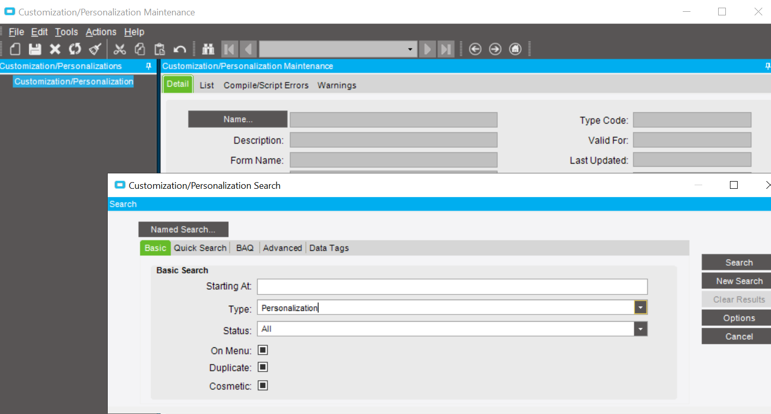

Remove any personalizations for that user.
May I know how to remove user’s personalization? Is it possible remove from MS SQL? I do not have purge tool.
Thanks for your reply.
But you do have the purge tool, it’s called “Customization Maintenance.” Search for the Personalization, open it, press the Delete button.
Thanks!!
