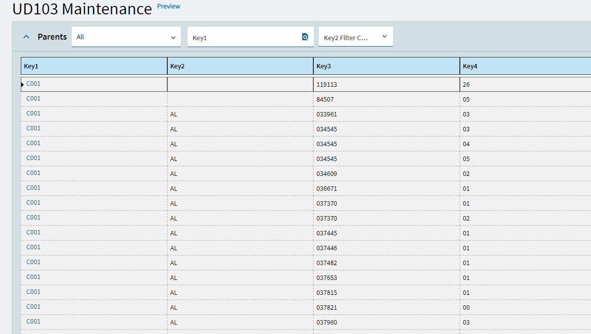

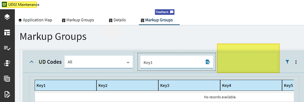

How I can add another search filter but combo box for the grid search? I want to place combo and add values from UD02.ShortChar01 and use it as a search criteria to filter records in the grid.
So, without testing this, add the combo box, then hook an event to it. In that event, call the dataview-filter widget based on the value of the box and filter whatever view the grid is bound to.
Alternatively, add a new view to where it says “All” at the top-left and add your combo box items assuming there’s only a few. If there’s a lot, that’s not really feasible.
Hey Hannah,
Sorry for the delay in response. It seems not to work for me. I tried your first suggestion.

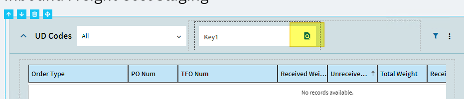

Also, what if I want to customize grid columns with Key1 search button? By default when I click it, it shows all columns from key1… But what I required is to display only UD columns.
Okay, so you have to do a rest call with a where clause to filter it.
Combo bound to TransView (can be bound to whatever, but TransView is a good runtime View)
Create a new event when your bound column is changed.
Add a rest-erp widget and configure as follows, but modify for your specific BO.
This is how you do the where clause filtering:
Key2 LIKE '%{TransView.FilterCombo}%'
Set whatever page size and absolute page you want. 50 and 1 respectively is standard.
Return the results to the LandingPage view.
Voila!
