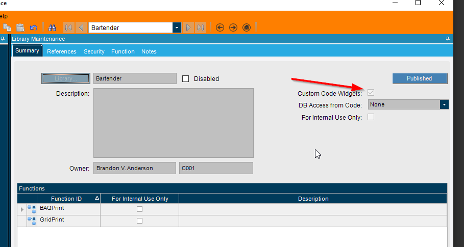

I don’t see a custom code widget in the EFx designer. I also see no way to iterate over records in a tableset. This is the very first thing I want to do in my very first EFx.
Do you have this check box checked?

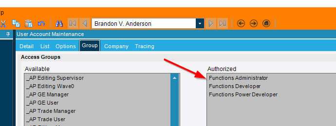

Also there are security groups that need to be added to get all of the functionality of functions available to you. Make sure you add those as well. (even if you are a security manager, you need those)
I was already a member of those groups. I checked that box, saved, and closed and reopened Functions Maintenance. There is still no custom code widget in the designer.
Edit: Oh, I see. I have to delete my function and recreate it as a “function with code.”
