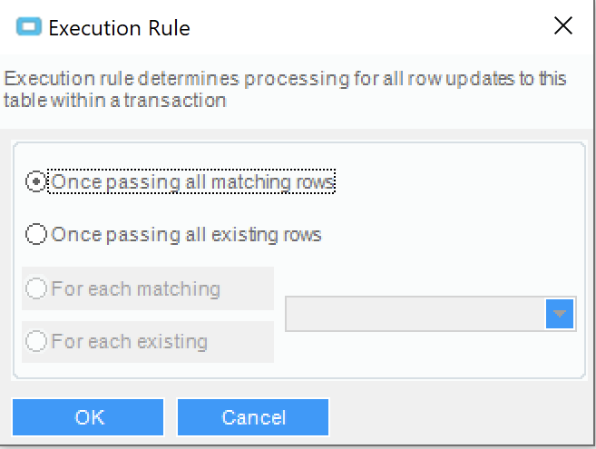

Add the ability to Group Widgets so the group can be used on more than one result row after a condition widget so you don’t have to use custom code to loop through. Or even if it was only the Function widget that had the ability like the custom code/email/autoprint widget in a standard directive. Maybe there is a solution that exists that I’m simply missing. :man_shrugging:
