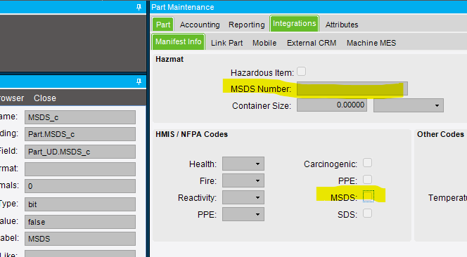

We just store the MSDS number on the part.
we added a few other UD fields to store critical safety info if needed.
we have a dashboard that shows all parts with Hazardous item as True
