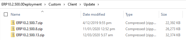

Custom: Is where individual updates and custom deployments are put. (Custom Dlls etc) that’s what those zip files are.
ReleaseClient.zip: This is the main client files download that gets downloaded by the installer when you first install Epicor. Then it goes into the Custom folder and downloads any updates from the zip file.
