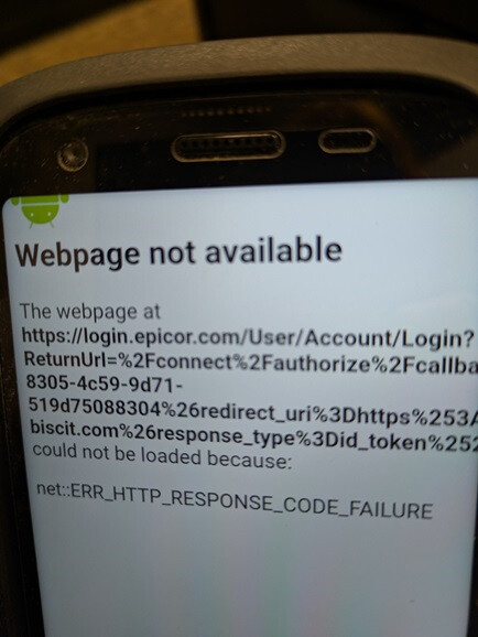

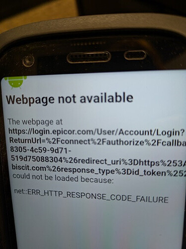

Is anyone accessing EKW on handheld device using IDP? We implemented Epicor IDP with SSO required and browser UX for all users. One exception is Epicor Kinetic Warehouse (EKW) where we get error message with IDP. We can log into EKW with Basic Authentication. Per Epicor support, we confirmed the required reply URLs were already listed in the Java app per Knowledge Article KB0113196. Once we enter the Email/PW we receive the following error. Have you run into this error? We have Zebra TC22 handheld device.
