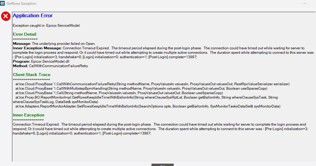

Epicor Cloud. What is the cause? Error
Message: The underlying provider failed on Open.
Inner Exception Message: Connection Timeout Expired. The timeout period elapsed during the post-login phase. The connection could have timed out while waiting for server to complete the login process and respond; Or it could have timed out while attempting to create multiple active connections. The duration spent while attempting to connect to this server was - [Pre-Login] initialization=3; handshake=8; [Login] initialization=0; authentication=1; [Post-Login] complete=13997;

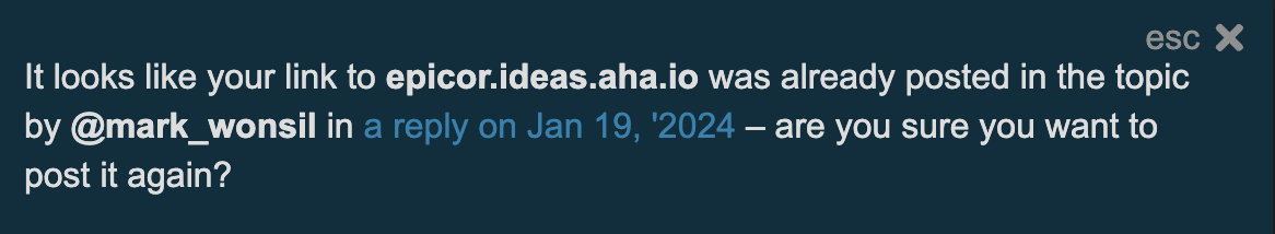

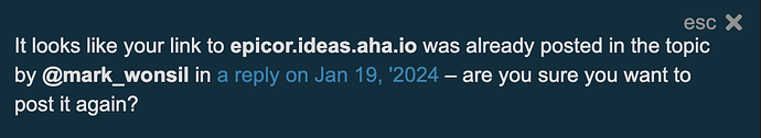

Thanks. Here’s another link for the hearing impaired.
Screenshot 2025-05-11 at 1.02.41 PM
Oh, honey…
