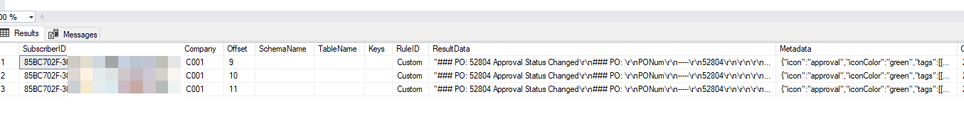

Anyone out there using Collaborate BPms to raise alerts? I have a BPM setup to raise an Alert when a PO is approved that part is working in terms that I see them in the subscriber’s queue table.
But they never seem to show up in any stream.

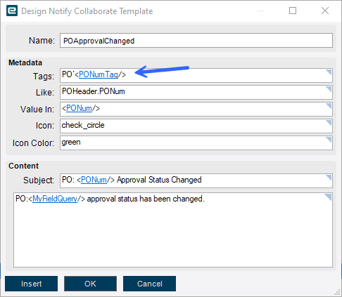

Ok so I finally got it (I think) it seems it s VERY picky about the Tag it needs to be
XXX`<field>
and no @jkane I didn’t create a custom notification rule it seemed to work with out it once I knew the magic incantation for the tag.

So this was a BPM on ChangePOApproval problem is that the BPM Widget doesn’t really tell you what to put in the boxes the “Tag” one is important it seems I had In there just
POApproval -- didn't work
Then i tried
PO<PoNum/> -- didnt' work
etc

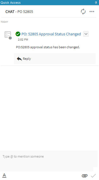

Apparently this is the ticket
This now makes a custom rule available that people can subscribe to and see in their streamline
