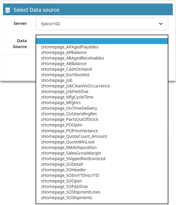

I don’t have EDD setup anywhere right now to test but at one point i had to use “zHOMEPAGE” at the start of the BAQ ID for it to show up in the data sources…
If you are only seeing the zHomepage BAQ’s - you are most likely still using a pre 10.2 Epicor license. Ask support for a new 10.2.x license with EDD Basic included. You can then load this license against EDD and license users within the EDD Admin page. You will then see all your custom BAQ’s.

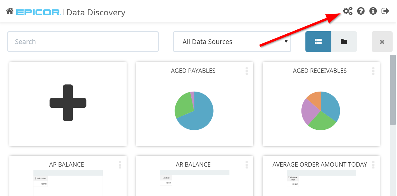

It took me a while to figure this out. Everything is actually done inside of EDD, not in the Epicor Admin Console (except to actually turn on and deploy EDD).
  1. Go to the Settings inside EDD
  2. Click on “Licenses”
  3. Click on “Add License”, then upload your license file
  4. Once added, click on the “Edit” action for your upload license
  5. Search for a user that you want to be able to use EDD, then make sure that the “Is Licensed” box is checked.
