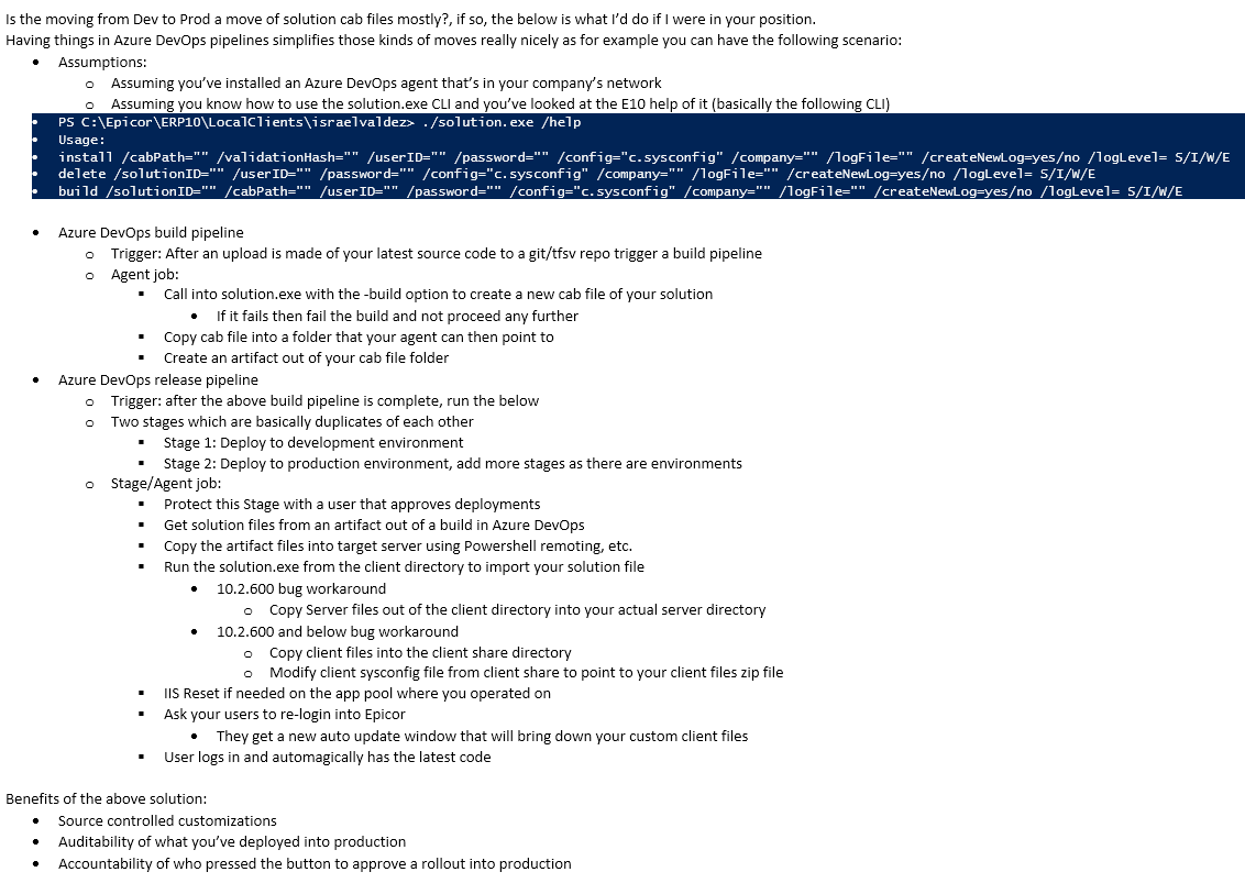

I can share perhaps a theoretical example I got from @ivaldez and @Bart_Elia when I asked what paths for automated deployments I could take. It may jiggle an idea in someone.
Do you have a Visual Studio subscription? If so…
I might have missed this part
Assuming it was Customization deployments…
