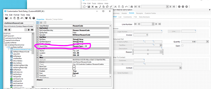

Hi Epicor community,
I am trying to do the same thing mentioned in this thread:
https://www.epiusers.help/t/filtering-unused-reason-codes/51378/3
But the Search Filter disappears.

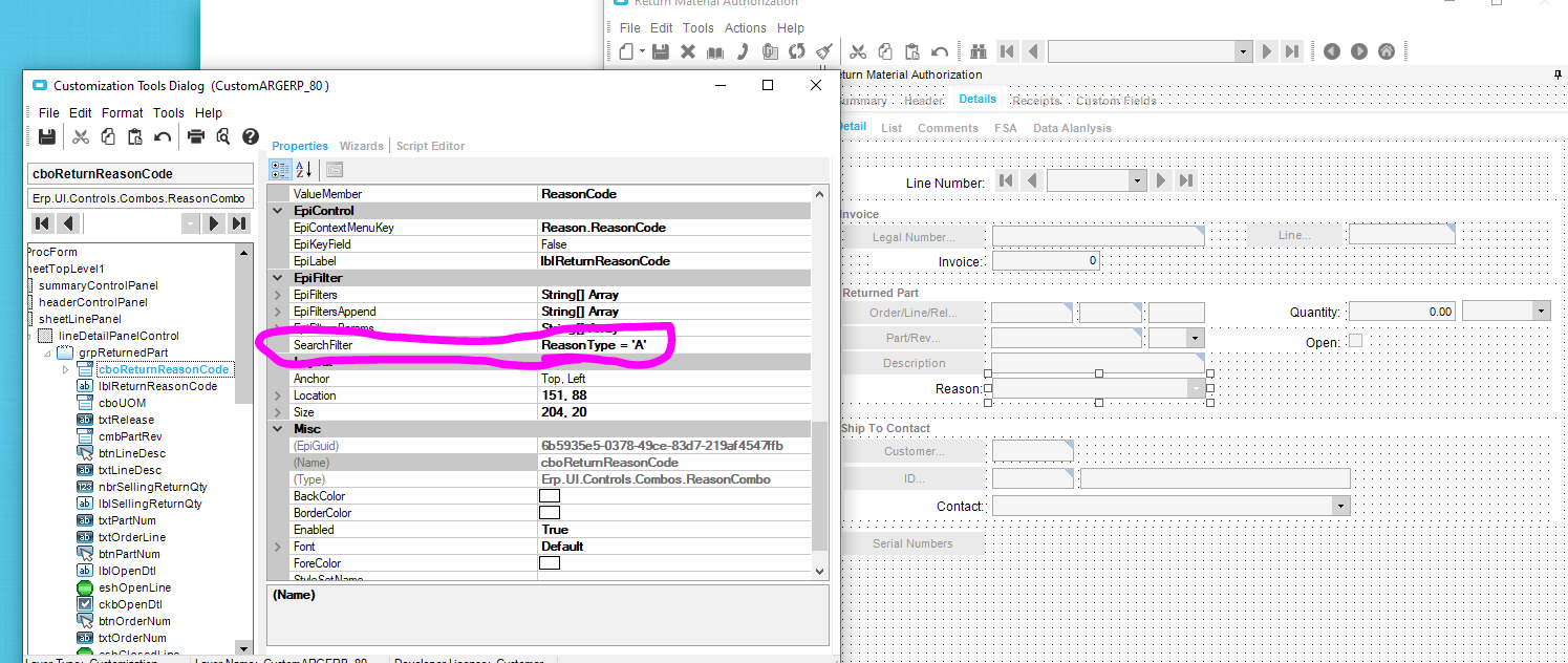

I’ve found you can’t modify the fields that you just let Epicor put in the Tracker. As a result, I nearly always clear the fields in the tracker view so it’s blank, then use Customize Tracker View and add my own controls. Those controls you can attach events to and/or set filters on.
You can just hide the cbo field and add your own epiCombo to do the job since it looks like you have a lot of fields on the tracker
You are a legend!
