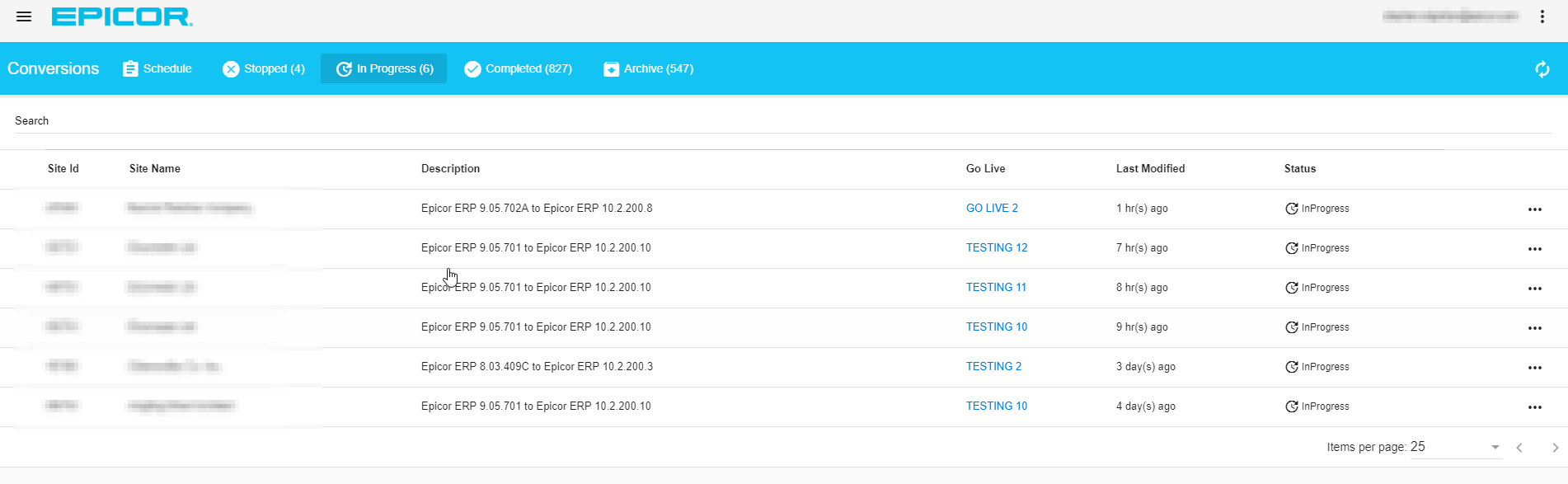

So Upgrade Services has done arround 1374 DB Upgrades from various versions - here is an internal view we see
6 are going though as I look and one is a go Live being monitored by our team arround the clock. So what are you getting when you use Upgrade Services - Consistency and Repetability - its all automated - when you press upgrade DB - we back it up - compress / encrypt push it to the cloud then kick off a conversion VM that is locked down with all of the dependancies needed to go from version 8 to the latest (no one logs in to do things its all automated including running some reconsiliation reports) - we are just verifying 10.2.300 even (although that is not out just yet) but the key here is we know what is slow, we know what data issues we need to fix, we can optimise where we place LDF and MDF files, we know how many cores we have so can configure the tooling to be optimal and we can fix the older conversions that may not be optimised for SQL or progress. If there are data issues we have everything already in palce to debug and resolve. We know upgrading has been a pain - and there is more engineering effort occuring to make it a non event. We have new things comming in the latest release to make things easier and more automated and that will continue. Once you are upgraded it makes our joint lives eaiser - you still need to do work but we are happy to help you here also. It is not about making money from the process - we all win with you on the latest and greatest.(TLDR: Epicor say no to the DUU, they’ll give you zero support on it, so it’s Cloud Upgrade service or the highway.)
