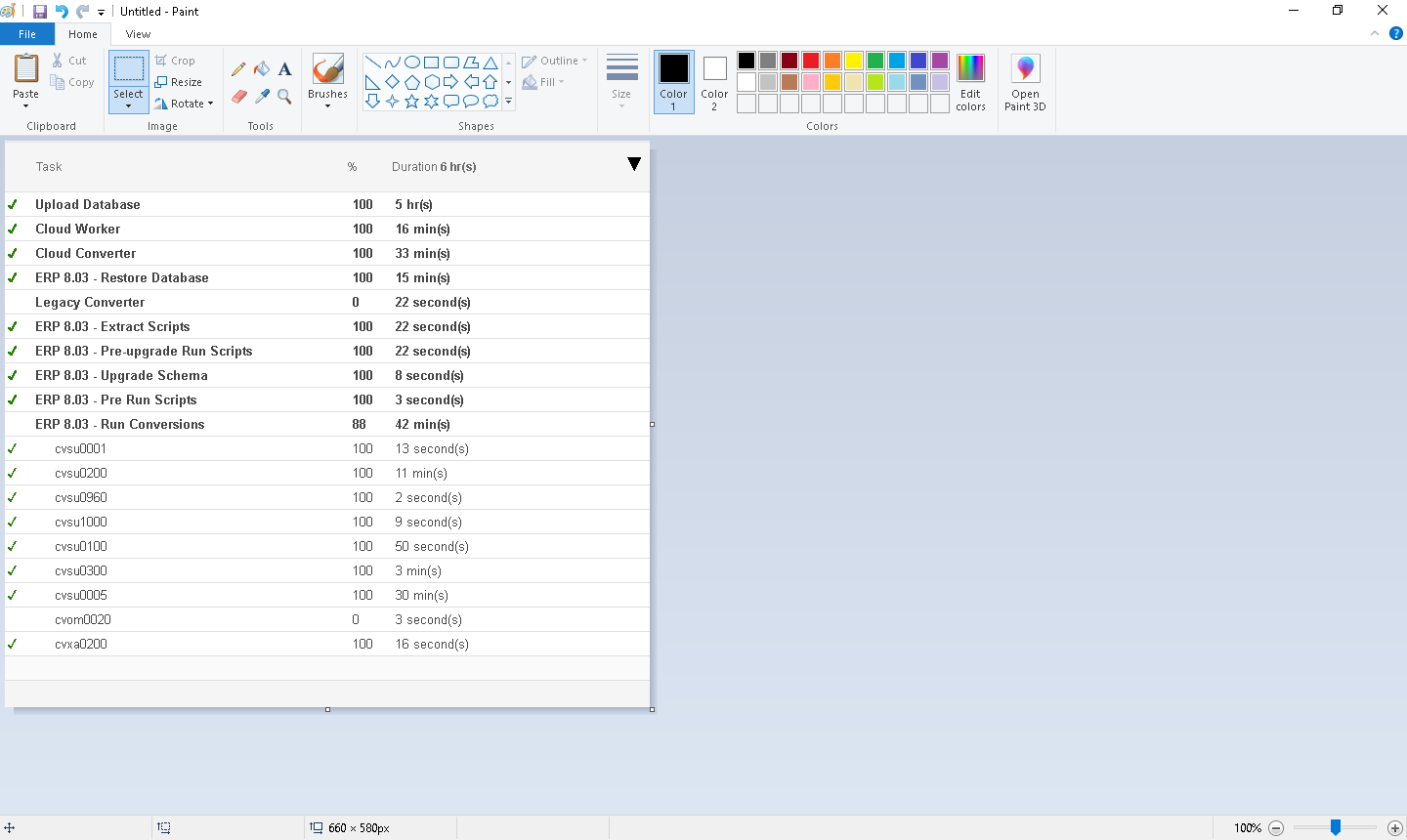

the run conversion has been on 88% and 42 mins for 2 days now. Epicor says its still running maybe it takes longer from 8.03.409C instead of 9.05.702A. Will give it a day or two before i ask them again!
Jose
Thinking the same thing, you have a few extra layers with 8.XX. It will error out when it fails and you should get an email indicating so. Good Luck.
Great! Havent gotten any errors or email yet. So thats good news!
Jose
